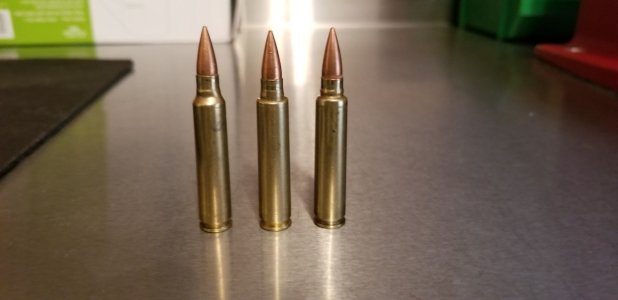

As I started the process I finally stopped after a few rounds to inspect the outcome and as the pic shows it didn't go so well...but wait, there's more. Upon extracting the last round from the resizing die I rip the base of the casing. Now I have a live round stuck in the sizing die...or what could be considered a barrel-less rifle. So I start with the inertia method and smack the die on my vice in a vein attempt to get the bullet to fall out...of course, no dice. Then came the needle nose pliers...and once again, no beuno. So I grab a glass of iced tea and reassess the situation. I don't load compressed rounds and knew I had room in the case between the bullet and powder. So I gently tap the bullet into the case with a punch, dump out the powder and proceed to tap the case out of the die...Voila, it worked.
