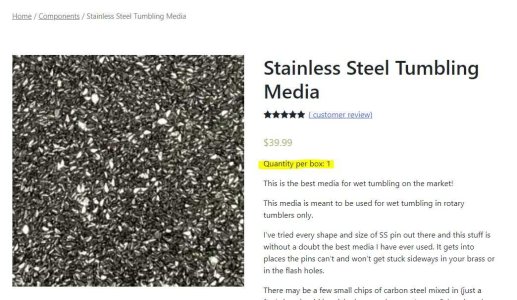

I’ve switched to wet and like it better. But I use chips instead of pins- https://sleepinggiantbrass.com/product/stainless-steel-tumbling-media/
Thanks for the link... That said... I got a good laugh when I looked at it... those are some seriously expensive chips! Guessing I'd be about $39,990,000.00 before I had enough to run a batch of brass. :D
