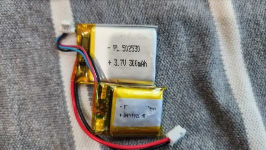

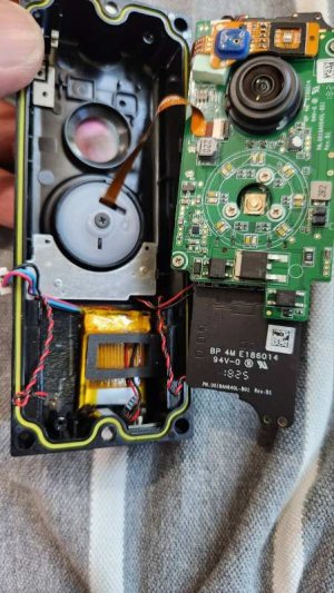

I'm sick and tired of repairing my Ring doorbell.
I have changed the main power supply that powers the chime and recharges the internal battery of the main Ring unit. Now that internal battery is busted and won't hold charge anymore, and I can't find a replacement.
A new unit will cost about $200+
My plan is to just use an ordinary doorbell, and have a camera that detects and records instead.
What do you use and recommend???

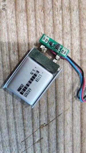

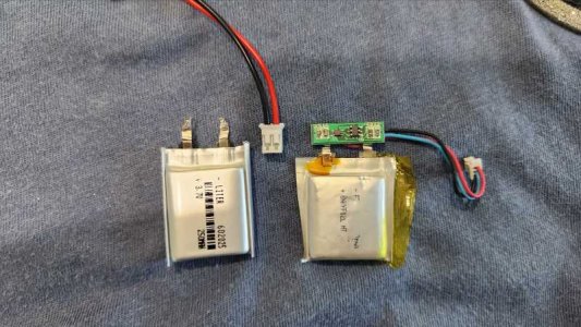

Ok, I found a similar size battery, but it's only 3.7v 250mAh instead of the original 3.8V 300mAh... I have no choice... after transplanting the old pcb to the new battery, my ring doorbell now works.. now I know this will be temporary, it might work for a few months, it might work for a year... we'll see.
