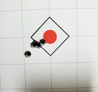

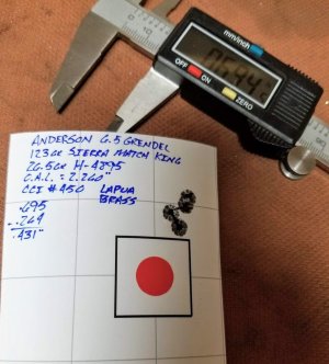

I have two Grendels one in an AR and one Howa Mini action. Both are shooting really well with H4895. The AR is running 26.5gr with a 123gr Sierra Match King and the Howa is running an 85gr Sierra Varminter with 29.0gr

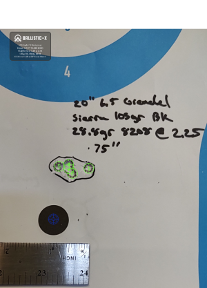

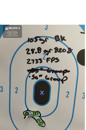

Thread back from the dead. Been playing around with my AR Grendel again and looking for an economical yet accurate load. Stumbled upon the 105gr Sierra BlitzKing, reasonably priced ($230 for 500) and decent aerodynamics (G1 of .425 above 1750fps) so I gave them a go. So far not disappointed, found an accuracy node pretty quickly with 28.8gr of 8208, Load chrono'd at 2733fps avg thru my 20" Faxon Match barrel. Duplicated the results in three shooting sessions and 2 different rifles. Would be looking at .50 MOA if I could quit pulling 1 of 5 shots.
Don't have much 8208 left so am going to try and duplicate results with ARComp.
