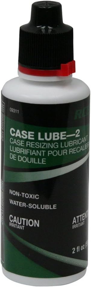

I use a water soluble lube and a damp rag.
https://www.amazon.com/RCBS-09311-Case-Lube-2/dp/B000PWDF32
