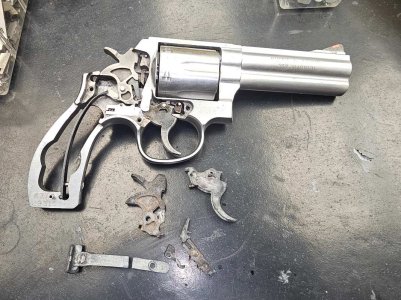

You know, when Dad was on PhxPD, he carried a stainless S&W M60 .38 snubbie as a back-up gun. And because he was on a walking beat in the Deuce, he sweated all over that thing, which is why he bought the stainless steel gun in the first place. It didn't take him long to stain that "stainless" revolver.
It looks like this was an early Model 686 when the frame, cylinder and barrel were stainless but the lockwork was still carbon steel. I'm almost willing to bet something similar happened.

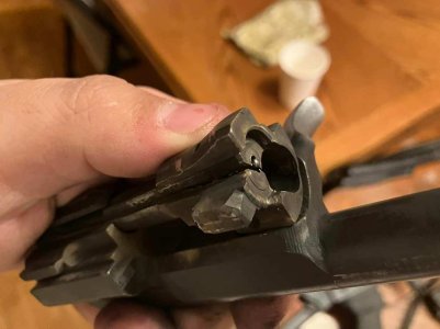

So when you're loading your own AK ammo, make sure you don't forget the AutoComp pistol powder is what you have in the powder hopper and not the CFE Black you THOUGHT was in there.

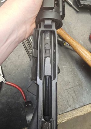

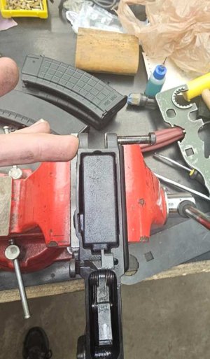

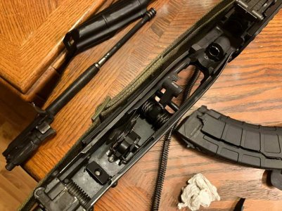

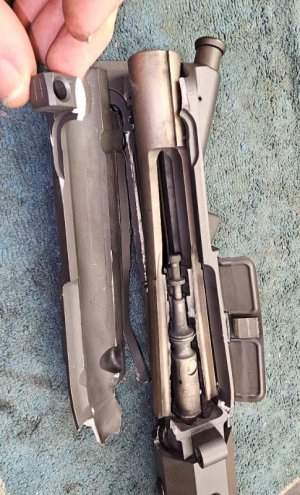

Customer brought this in.. Customer states that the ammo came from a sealed plastic bag his buddy gave him. :shifty:
I didn't get a picture of the extractor that was bent into an "L". Even the top of the carrier was split from the front of the carrier to the cam slot..

Really? The upper receiver is cracked in 2 places that I could VISUALLY see, the BCG is trashed; the bolt MAY be good but without doing an NDI inspection on it I am going to assume it is bad/fractured also. The brass is welded in the chamber, the mag well on the lower is bowed out with signs of stress where it is bowed.. Not much really left to cannibalize. So, I guess I am the ignorant one here.. :think:

I never said I tried to fix it. I just went through it so the customer can make an informed decision on how to proceed. He decided to just replace it with a new one.
Also this is the "Blown up and ruined guns" sub forum, correct? That is what I posted, a blown up rifle more then likely from bad/unknown ammo.

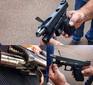

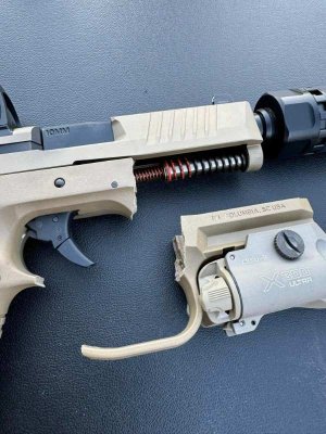

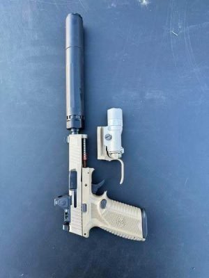

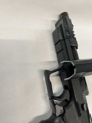

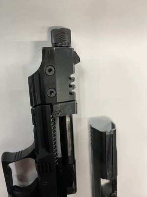

FN510 broken 1.jpgFN510 broken 2.jpgWhat is it with Scott at KENTUCKY BALLISTICS and guns blowing up in his hands?
He just had a 10mm FN510 try to bloody his knuckles.
https://www.youtube.com/watch?v=Yjw_UB-LMrI

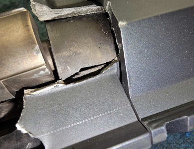

Scottsdale Gun Club, Feb. 12, 2025. Guy in the lane next to me was shooting a Walther P22 with Remington ammo.
Dayum, that's a neat cut. Wonder if Walther will warranty the slide. Not like it blew the barrel....
Those P22s have been known for a while to do this more frequently than you might suspect.

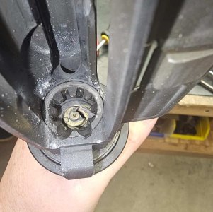

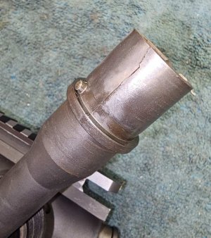

300 Blackout fired in a 5.56mm barrel claims another victim.. You can still see the back of the bullet through the big hole in the case.

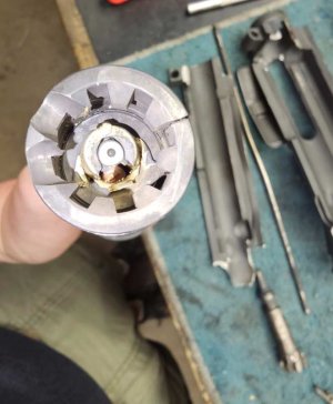

7MM Rem Mag round in a Weatherby Ti 6.5-300 will most assuredly turn the rifle into a $4000 paperweight. If I can find the pictures I'll post them here. The neck portion of the 6.5 chamber will act as a throat section for the shorter 7 round, and if the dummy is determined to force the bolt closed and pull the trigger, all 9 lugs in the receiver will set back and crack.
