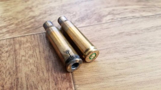

Rifle is my frankenstein AR-308 that started life as a DPMS LR-308 circa 2007. Been through several barrels and stock configurations. Still using the original receivers and bolt group.
Anyway, last range trip or two noticed a bit of cratering around the primer. Less so on surplus M-80 than commercial. No issues other than that. Rifle is MOA with the current Fulton Armory Criterion 18.5" barrel.
Last range day, had a jam and noticed smoke coming from the upper-lower receiver. Cleared the jam and continued without incident. Later noticed the blown primer and even later that the case was split.
Attached photo of that and another case from that lot of Privi Partisan 165gr ammo.
What would cause such a thing? Never checked headspace, have some gauges on the way and a JP high pressure bolt to be installed.

My first suspicion would be that the chamber mouth is too generously belled. This is often true of many automatics designed for harsh use like belt-feds. In such designs, accuracy is not as important as reliability and so the chamber is ever so slightly larger than need be in case the round gets chambered with some crud or grit. This is the entire reason "small base" dies exist, so that brass fired in such over-sized chambers can be reduced down to standard dimension to work in more standardly tight chambers.
I have owned a few M1 Garands with generous chambers like this, but other than being a pain in the butt to resize, I've never experienced a case split like that. Perhaps it is a combination of the generous chamber AND hot ammo? Either one by themselves might not cause a problem, but together,....

Man, I don't know. I've seen neck splits and case-head separation, but that vertical split has me scratching my head.

I don't see any flattening of the primer?
I guess to me it looks like the case head isn't being properly supported?

Is the PPU loaded to .308 specs or 7.62x51 specs? M80 is loaded to 7.62x51 NATO specs and as such is slightly milder than civilian .308 Win. chamber pressures. Usually no issue, but might be an edge case in this instance. What bullet weights for the two different loads? That split case head and the specific location of the split looks like the bolt might be unlocking a little early and the case head would be unsupported as it unlocks.

The remaining PP ammo shot fine with no primer indent weirdness, so I am thinking it was just a faulty case. I run an adjustable gas block so premature bolt unlocking would not seem to be possible or I would have seen some signs by now.
