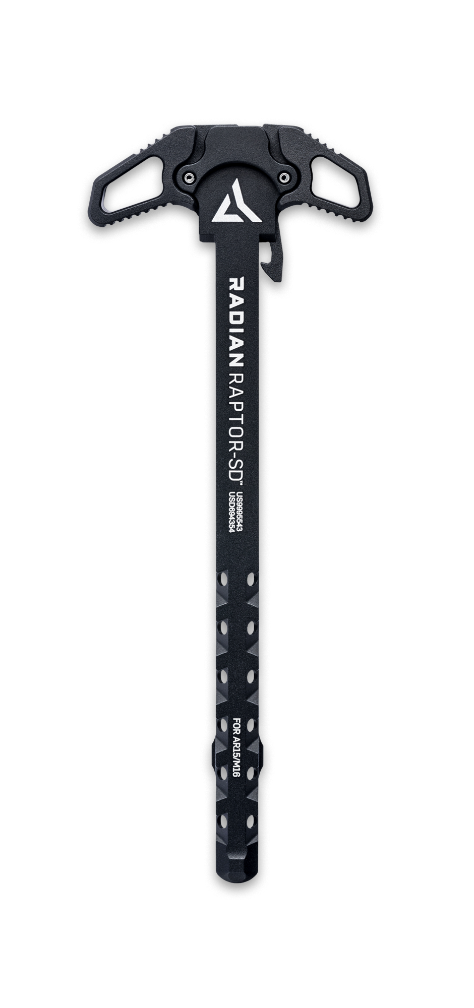

If you are going to shoot a DI suppressed get a Radian Raptor SD charging handle
Notice the ports to dump into the bolt area and it has a lip on the end of the charging handle to direct gas up and away from directly back in your face.
