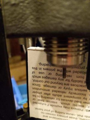

If your sizing die and decapping pin doesn't look like this you need to adjust it to look like this. Only reason a primer doesn't get pushed out is the decapping pin is not adjusted right. ________________unnamed.jpg
I agree with the above. You said you did try adjusting the decaying/expander pin but perhaps it wasn't adjusted enough. What 9mm dies are you using?
