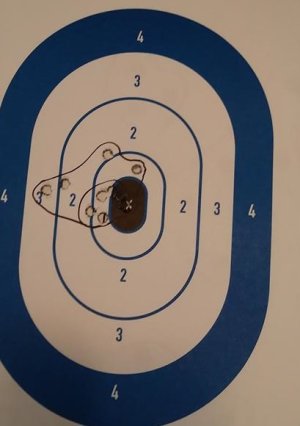

I am a big fan. I really like the reduced recoil over my old 308, availability of cheap blaster ammo (wolf) and the biggest plus is you can use an existing built AR lower. My 24" barreled upper has turned in sub moa groups at 100. Here's one of my load development targets from last year, 95yds, 123gr AMAX over 27gr AR-Comp. Outer circle is the 1st 4 shots, inner is the second.

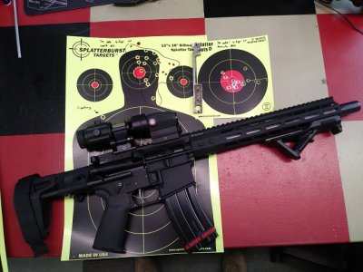

Just built a 12" pistol a few months back. A quick sighting in at 70 yds using a foam block, red dot and 6x magnifier netted me this (Wolf on left, Hornady Black on right). I need to get out my rifle rest and see what the pistol can do.
