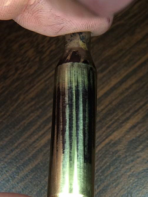

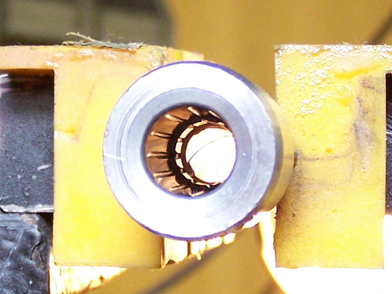

Well here is the deal. Stoner never made the AR to take steel cases. Chamber tolerances, the way the locking lugs work and the extractor design never had steel cases in mind.
Here are the differences in the chambers you can get in the AR15
•The first is the Mil-Spec 5.56mm chamber, which is used in the M16 and M4.
•The second is the .223 chamber, the most common chamber in AR-15 rifles, although you can
get AR-15s with a 5.56mm chamber
•The third is a .223 Match chamber, which is used in AR-15s by serious competitive AR-15 shooters.
Even with all these options they still don't like the steel cases.
M16 and AR15 (Armalite Rifle 15) chambers are basically the same other than the three from above.
The problems you are going to face with steel cased ammo.
1. Stuck cases
2. Double feeds
3. Broken extractors
Our army and country run brass cased ammo not steel. Everyone I have ever encountered that tried to run steel cases dry stuck cases starting around the first 35 to 40 rounds. When the AR heats up and you have steel on steel going on and that's when you have malfunctions. I'm not saying you can't run steel in your AR, I have. I get 40 rounds through it before I have issues. Using a lot of oil I get 80 before experiencing problems. I fixed all me issues when I had my chamber fluted like the HK91. After that I never had a problem. But we are not talking about modified AR's, we are talking about AR's off the shelf from the factory.
Here are some pictures of fluted chambers and a case once fired from a fluted chamber.

There is at least one AR manufacturer that is doing fluted chambers right from the factory.
It seems the AR wasn't a perfect design, no matter what the fanbois might claim.

Who is making the fluted chamber?
