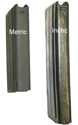

A true inch pattern FAL is less common on the used market. They would generally be from British commonwealth countries. The L1A1 is the most common. The major difference is the magazines. The metric magazines are far more common, and many "inch pattern" civilian L1A1's were built on imbel metric receivers so don't work with inch mags. There are other parts that are not interchangeable as well. I believe the metric mags fit the inch rifles but the inch mags wont work in most metric rifles.

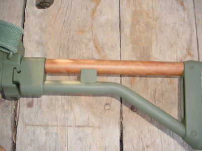

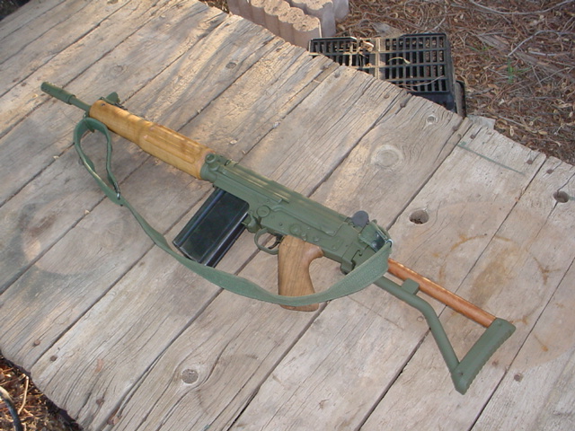

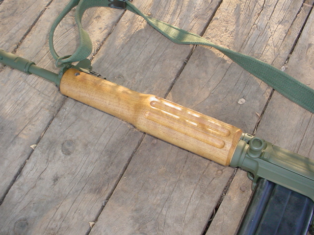

Wow Conelrad thats sweet
- Conelrad
- Posts: 130
- Joined: December 12th, 2018, 11:38 pm
- Reputation: 6
- Location: Maricopa
Re: FN FAL
Thanks for the compliment!

Metric mags are easier to find
Sadly, the prices have gone up. Guy at the last show I was at wanted $40 each...no thanks.

On the subject of mags, don't get suckered into those from DSA...they don't work.
You can tell them by the two parallel stripes on the front, DSA mark on the floorplate.

Moses mags are pretty good...
