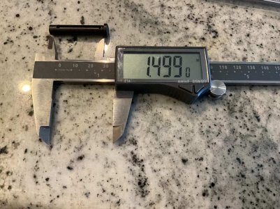

I know that I'm late to the party - but - if you can throw a set of calipers on it and see what dimensions are that would help? I bought a pivot and takedown pin from S2 Tactical (43rd Ave and Bell) a few weeks ago for my Aero M5 build. The pivot pin was too short (well - it worked - but it didn't protrude out of the far side of the lower - so I had to use a tool to pop it. I ordered the "correct" length pivot length pin from Aero and pulled the other one out.
So - you might find what you need at S2 (they sold me a few other parts that saved me waiting for things to ship) and / or - if the one that I pulled will work for you I'm happy to get it to you.
Here's the pin...

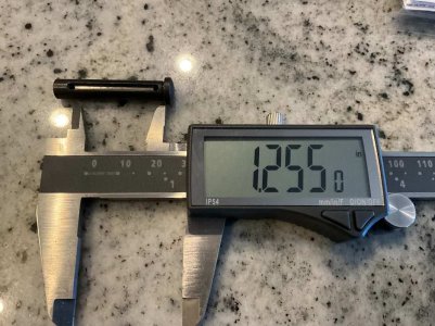

I think I had misread your post previously. I read it as 1.10" to the dimple. I'd bet that if I put calipers back on it when I get home, it is 0.110 to the edge of the detent cut...
