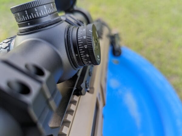

After having a little fun and enjoying myself, I assumed a resting position at 100 yards. The gun was benched on a backpack, and I popped the turrets off. I set up a fresh target and wanted to check the turrets’ measurements. The adjustments per click are ½ MOA, so two clicks at 100 yards should be approximately 1 inch.
PSA JAKL 5.56 Rifle w/ Monstrum Panzer 1-6x FFP Riflescope

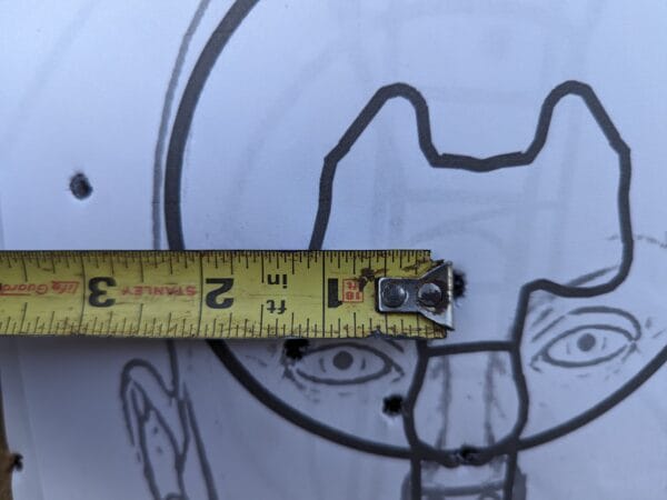

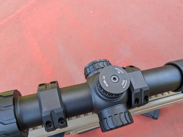

I fired a three-round group as a control group. I then dialed the optic 1 inch to the right and fired. The shot landed 1.5 inches from the group. There is certainly some room for shooter failure. I dialed the optic back to zero and fired one round, and it landed roughly one inch to the right from my furthest right shot and 1.5 inches from the center. The zero was effectively gone.
I kept it at the ‘zero’ setting and dialed one inch to the left. The shot landed three inches from the original group. I got a new target and worked the left and right measurements. Adjustments to the right were consistent, but adjustments to the left were always excessive, with a 2.5 to 3-inch ratio per two supposed ½ MOA clicks. I got the gun re-zeroed, but it again took a lot of ammo and time.
