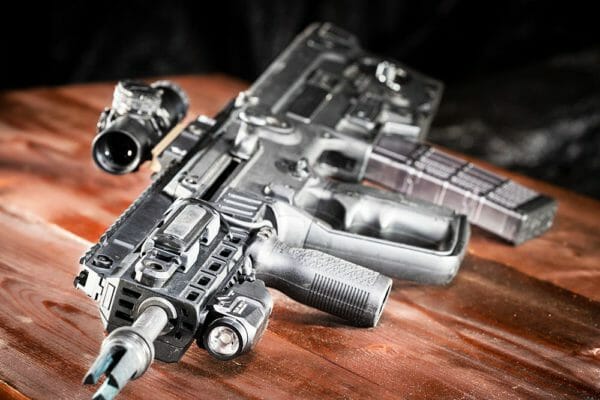

The IWI or Israel Weapon Industries Tavor X95 Bullpup Rifle has been around for a while, but still runs like a scalded dog. IMG Jim Grant

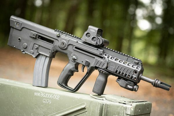

Although a very modern design, under the hood the IWI X95 is essentially an AK-47. IMG Jim Grant
Chambered in 5.56/.223, the X95 is the civilian version of the Israeli Micro Tavor. Both firearms operate via a long-stroke piston-driven system that is famous for its durability and reliability. (It’s the same basic method of operation used on the AKM as well as the M1 Garand.) Available in both 5.56mm and .300blk, the X95 feeds from standard AR-15 magazines (STANAG-pattern) that are available in basically any capacity physically possible.
The body of the X95 is constructed almost entirely of polymer, with the barrel, action, and mechanical components all being steel. These polymer components are available in OD green, FDE, and of course, plain ol’ black. I choose the latter because everything goes with black. But back to the internals for a moment.
While the X95’s long-stroke, gas-piston method of operation tends to make firearms heavier, and suffer from a very forward center of balance. (This is because a long-stroke piston utilizes a bolt carrier group affixed to the piston, resulting in a large, heavy mass. This also has the adverse effect of adding to the recoil impulse, since said mass is traveling at high velocity inside the firearm.) The latter of which makes these types of firearms extra tiring to shoulder for longer durations of time because the forward weight has leverage against the shooter themselves.

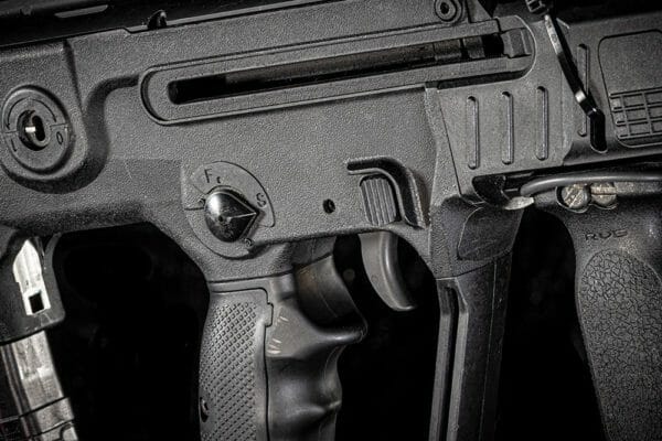

While most bullpups have awkward controls, the X95’s magazine release and fire selector closely mimic those of an AR-15. IMG Jim Grant

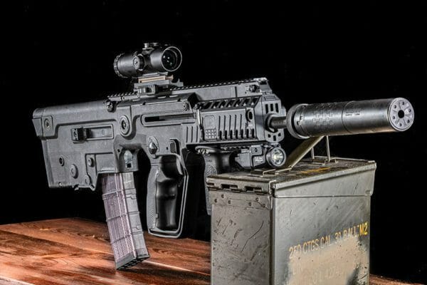

The IWI X95 might not be the most accurate carbine on the market, but its compact size, lightweight and impeccable reliability more than make of for that. IMG Jim Grant

As for the trigger, the X95’s trigger is excellent for a bullpup firearm. While not much better than a mil-spec AR-15 trigger, the pull feels normal and it breaks with reasonable crispness. There are aftermarket options available, but I found that the factory trigger was sufficient for appropriate distances with the X95. And The terminology used in that last sentence is intentional but we’ll get to that later in the article.
The manual of arms is a different story. While the X95’s use of a push-button magazine release located in close proximity to the pistol grip is excellent, and objectively an upgrade of the full-sized Tavor, reloading is still fairly awkward.

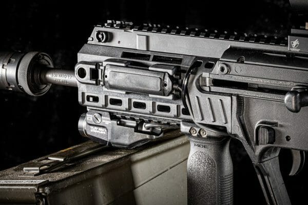

The X95 features a three-sided rail with QD panel covers that are great for mounting lights, lasers, or grips. IMG Jim Grant

Another drawback is the gun, is its tendency to blow carbon back in the shooter’s face when paired with a traditional sound suppressor. I found that a thorough cleaning dramatically reduced this, but the only real solution I found thus far is to use a cleaner suppressor like those from OSS, which captures the majority of the hot gas and carbon blowback before it has a chance to enter the weapon’s receiver. But on a very positive note, the fact that the center of balance is much closer to the shooter means that the added weight and length of a steel suppressor aren’t nearly as noticeable.
