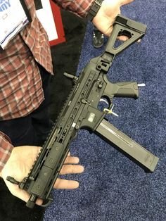

The New LWRCI SMG-45 Pistol Caliber Carbine ($3K though)
