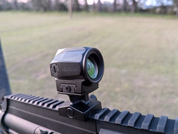

The SCRS RD 2 still has a battery. It’s just inside the optic and non-removable. That integral battery can hold up to 20,000 hours of power! Red dots don’t need much power to work, so solar can run one without much of a problem. The extra battery ensures you can use the optic when the sun goes down or when indoors in a dimly lit environment.

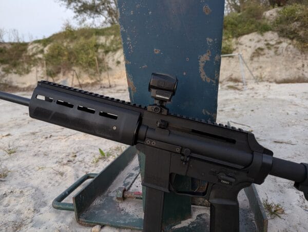

SCRS RD 2 on gun
The optic works perfectly on my Extar
Right off the bat, this is going to give people the willies. Can we really trust the battery to be charged when we need it? If someone kicks down the door and I grab my rifle, is the SCRS RD 2 going to work when I really need it to? Will I put it in the sun long enough to make sure it’s charged? How do I know if it is fully charged? Will the internal battery fail?
Yeah, I get it; it gives me the willies. There isn’t a way to know if the unit is fully charged or in a charged state. All batteries can fail, and this one isn’t user-replaceable. You’d have to send it to Holosun to be replaced or warrantied if it fails. According to the manual, it takes 50 to 60 hours of direct sunlight to charge.

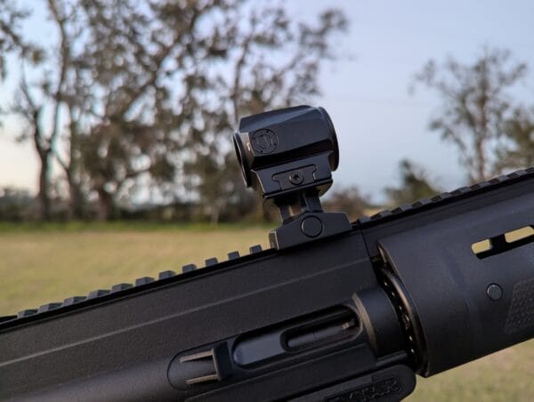

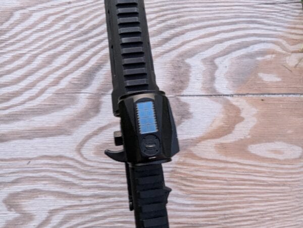

solar panel on optic
The solar panel on the SCRS RD 2 is the key to its success
When I start looking at the optic and the overall design, I wouldn’t rely on the SCRS RD 2 for defensive use and couldn’t suggest you do the same.

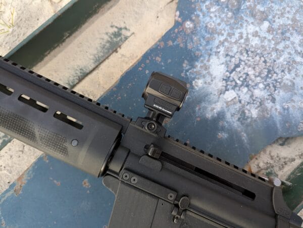

The SCRS RD 2 features three adjustment modes. We have an automatic setting that uses the solar panel to detect the brightness and adjust it automatically. These never work that well, especially in dynamic environments. It becomes an issue if you’re in a dim area aiming into a bright area, and vice versa. Weapon lights are a problem, too. It’s fine, but it isn’t my preferred mode.

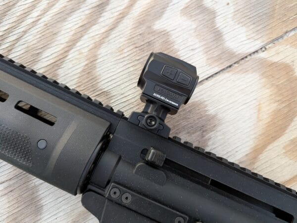

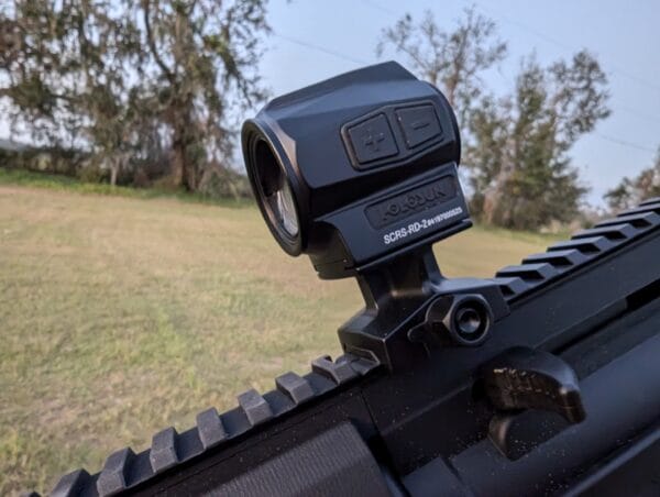

Our manual setting allows you to adjust the brightness via the side controls. It’s like every other red dot. The SCRS RD 2 has buttons on the left side for quick and easy adjustments. The buttons are big, easy to use, and provide decent feedback with every press.
SCRS RD 2 buttons
The buttons are big, easy to press, and deliver solid feedback
Finally, we have the lockout mode. This locks you into one brightness level of your choice. It’s not my favorite mode, and I don’t really know why it’s an option. Maybe it’s for the NVG guys. It’s certainly not for me.

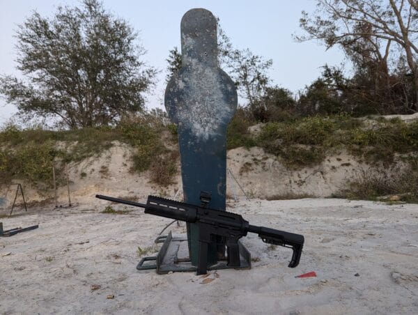

It also works fine with full-sized rifles and could be a good choice for shotguns if you ditch the high mount for a lower mount. I tossed it on a PCC and hit the range. Zeroing proved to be easy and quick.
SCRS RD 2 and steel target
Steel targets didn’t stand a chance
The clicks are 1 MOA, and that makes your adjustments broad, quick, and plenty precise at 25 to 100 yards—the range I’d use a PCC at anyway. Each click provides excellent feedback, and you can feel and hear the movements.

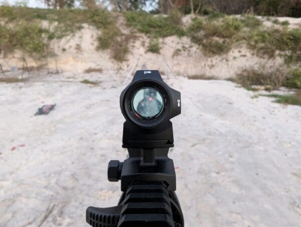

The dot holds zero without complaint. I can spray round after round downrange as quickly as I can, and there won’t be any problems. The dot has a seemingly solid refresh rate, and the dot tracks easily during recoil. At the sound of a BEEP, I could drive the gun to my shoulder and to my target in an instant.
SCRS RD 2 notch filter
The notch filter is visible, but not terrible
Driving the gun from target to target doesn’t cause the dot to lag or fail. It merely sweeps with the gun and maintains an easy-to-track status. The SCRS RD 2 works quite well and delivers the quick, instinctive shooting capability a red dot is known for.
