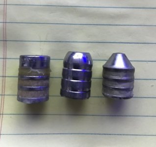

I think I got the hang of casting for my 54 cal muzzleloader.
Only problem that I seem to have is running the furnace wide open and the lead collecting oxide quickly with high temps. I seem to be fluxing and scooping a lot of crap out of the lead with higher temps required for the minie ball mold.
Left to right: 400 grain wad cutter? (not sure but its a fence post looking slug), 400 grain minie ball, 380 grain REAL bullet.

Your slugs look pretty good to me. I would not hesitate to shoot ‘em.

They look good. Good fill and minimal wrinkles.
For complicated shapes you need to run the lead very hot.
You look like you got the hang of it.

One thing I have been doing to get decent minie ball casts is to keep the lead pot thermostat wide open, and keep a hot plate near by cranked up to about 550 degrees to set the mold down on if I need to stop casting bullets for a minute or so. Most of the time the bullets just drop right out of the mold with no issue at all.
Yeah. That'll do it.
As long as the mold stays hot and the lead is as well. I have no problems filling out my .58 minie molds, the 405/510 trapdoor molds, and the wadcutters.
