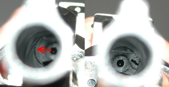

Make sure 3 times that it is unloaded.
Cock the hammer and shine a bore light down the barrel. Look down to see if any of the cylinder wall edges are visible.
If you can see the edge of the cylinder in the barrel it'll spit lead, powder and gas badly.

What he said. When the chambers are not precisely lined up with the barrel, a bit of the bullet gets shaved off.
