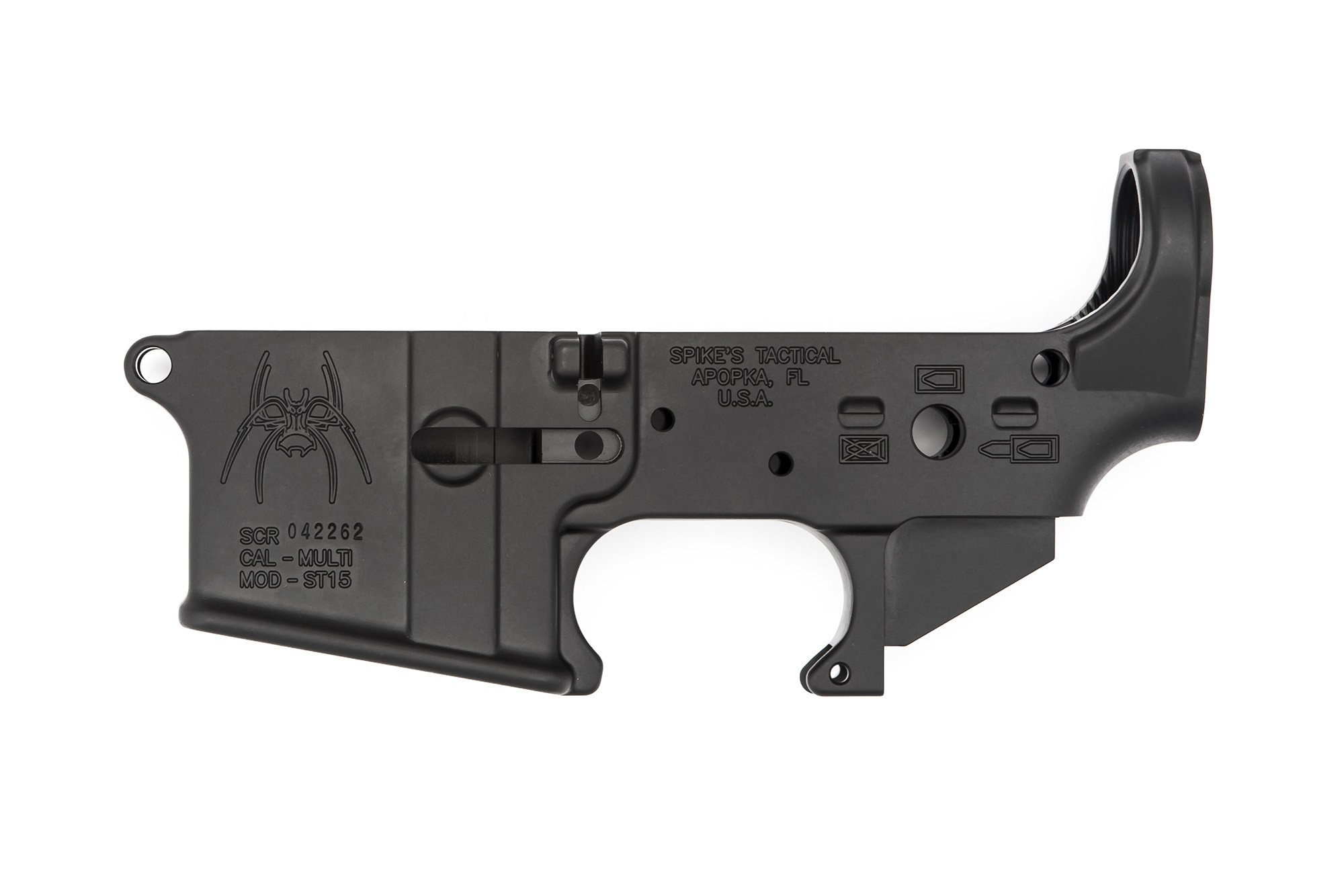

Becareful if you have two different caliber uppers, ideally your lower needs to say multi-caliber not just 5.56. this way you can use your 300blackout and 5.56 upper or whatever combo. But you need to list the lower as multicaliber
Notice on the Spikes lower it say Cal- Multi ... that engraving for caliber goes on your Form 1.
if it's a true stripped lower aka pistol it should be like this.
You don't want one like this PSA (not all psa are like this) and notice it says m4 Carbine
"Multi" has not been accepted by the ATF since 2015. You have to designate a caliber on your form 1.
Damn now I feel old... so how do you deal with AR lowers that can take different caliber uppers?
[/quote]
[/quote]
As long as the SBR can be reconfigured to it's original Form 1 condition, e.g 7.5" 5.56mm, you can do anything you want. Have a 12.5" 300 Blackout upper, a 7.62x39 14" upper, a 6" 22lr upper, etc, etc...
