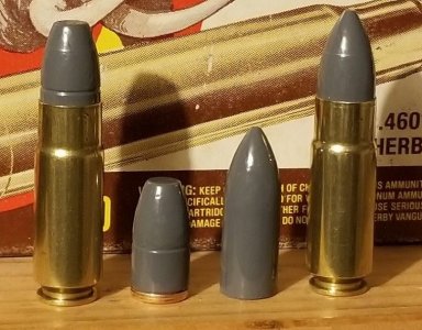

Below is a pic of my two favorite bullets I make and shoot in my SOCOM. On the left is a 360 Gr. PC'd bullet for both the SOCOM and the 45-70 (that is what the crimp groove is for). On the right is a 500 gr. spire point that I load for subsonic loads in the SOCOM.

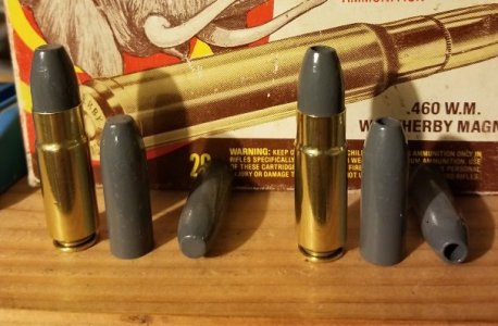

In the PIC below you can see a 600 gr. solid and a 570 gr. HP I cast from the NOE MOAB mould. This is a big long bullet and you can see how far it goes back into the case. Once again, not pushing it too fast because there isnt enough room to really do that. I can push it past 1,000 fps but try to keep it around that speed.

For these I use Accurate 1680 but most of the powder in this burn range should work like 5744, 4198 etc...

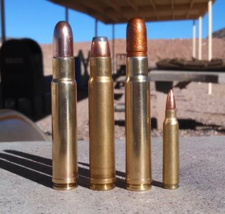

I just like that classic box with the elephant, makes a good backdrop. That is my "big" .458" so that is why when people ask about the recoil of my 45-70 or .458 SOCOM I have to say it is subjective. My .460 Weatherby is a Ruger #1H which weighs about 8 pounds so when you are shooting full power loads it thumps pretty good. a 500 gr. .458" bullet going out at 2,700 fps generates some power. I also shoot lower velocity cast bullets out of it for plinking loads.
In the pic L to R:
500 gr. Soft point
300 gr. JHP
500 gr. Lead coated
obligatory .223 round for comparison

Out of curiosity, why are you gas checking a powder coated bullet?

Because I can, Its a personal preference. I know there are lots of people out there who say you don't need to put a GC on a PC'd bullet and there are some that I shoot out of bolt guns that I do not. With shooting PC'd bullets in AR's, when I push them fast I like to have a GC on the base. I do not use them on my heavier subsonic loads in the SOCOM but with the lighter ones I like the GC.
I have never seen anyone argue against putting a GC on a cast bullet because it makes it perform worse than a plain base. Most arguments against GC's have to do with cost or extra hassle putting them on. Both of those reasons are insignificant to me so I install them. Basically I see no negative reason for having them, only positive reasons so I use them.
