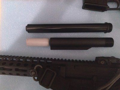

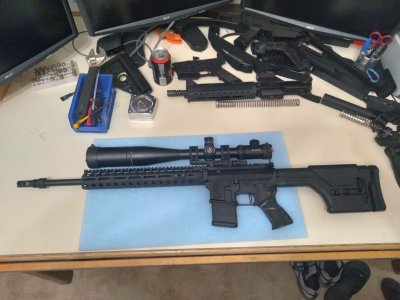

I had some time to build some stuff for myself for a change. I used my circle making machine to make a circle that would allow me to use a carbine spring and buffer in a rifle length buffer tube.
I drilled and tapped the end of the spacer so that it'd be secured in the tube with the fasten in the end of the buffer tube.
I wanted to put a PRS stock on a rifle that had a carbine length stock on it. It ran well with the spring and buffer in there, so I didn't want to mess around with a rifle length spring and buffer.

1.I am using a rifle length tube, not a carbine tube. The spacer is inserted into the rifle length tube so that I can use the carbine spring and buffer, which is known to work well with the upper. I used as longer fastener, so it secures the stock to the tube like you mentioned and then screws into the spacer. Although I made the fit between the tube and the spacer pretty snug, so it may not even be needed.
2. I assumed that a rifle length buffer system needed a rifle length gas system. I didn't want to mess with all that. I figure keep the known working components together as best as possible.

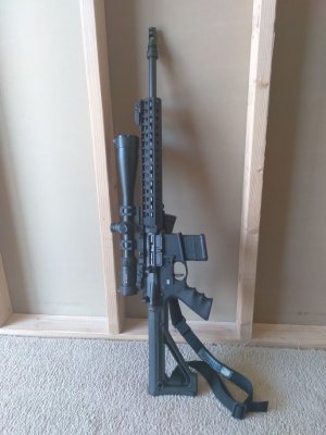

Ah, that makes more sense. I was Initially scratching my head, as the second pic above appears to show the PRS on a carbine-length tube set-up ;)

Right, I know the parts will physically fit and try to do their job. It's just that when I was using the rifle spring and buffer I have, it was short stroking with that upper. I don't know all the exact science on port sizes, port location etc, so it was easier for me to build this spacer and use parts that I had around than to buy more springs and buffers to try and get all this to work.
