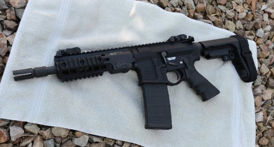

Above This is a 7" 5.56
Key Components
-Seekins billet lower with ambi bolt catch release and ambi mag catch (Norgon mag lever far side)
-Battle Arms ambi fire selector, Milspec trigger group, KNS anti walk pins.
-Vltor billet upper receiver with forward assist
-Noveske bolt carrier group. Bolt is head spaced at the factory to barrel and sold as a set.
-7" Noveske "Diplomat" stainless steel barrel. Note- I used to go to Robar for my SS blackening but they shut down all their stainless blackening operations. Now I go to "Louie's Black Oxide" over in Phoenix. He runs a very modest but quality operation, great work, great prices and quick turn around as in 1 or 2 days. (602) 257-0530
-Smith Vortex flash suppressor
-Geissele 7" MK13 rail (they recently discontinued their 7" rails, I don't know why)
-Troy BUIS, I prefer the HK style front site. (semi hooded)
-SB Tactical ABA3 pistol brace

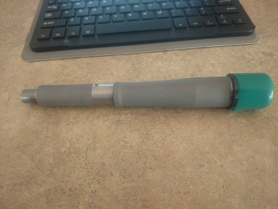

ETA- Point of reference. This is the 7" SS barrel finish before black oxide. Some people don't mind the color. I prefer the rifle all black.

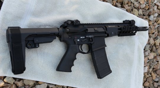

Above This is a 9" .300 Blackout
Key Components so far
-Seekins billet upper receiver with forward assist.
-Noveske bolt with Lewis Machine Tool carrier. Bolt is head spaced at the factory to barrel and sold as a set. I just happened to have the LMT carrier laying around so that's why I matched them up.
-9" Noveske stainless steel .300 blackout barrel. Again "Louie's Black Oxide" finish.
-Smith Vortex flash suppressor not shown
-Geissele 7" MK4 rail (they recently discontinued their 7" rails, I'm trying to find a distributor that still has one in stock)
-SB Tactical ABA3 pistol brace on order
UPDATE- ok, so this is the progress on the 9" shown above in the Photos shown below. So what's new? SBA3 brace, Geissele 7" rail that was nearly impossible to find, Vltor charging handle with the gas suppression dam, Smith vortex flash suppressor, Troy flip up BUIS. Also some paint filling on the fire selector etc.
I'm still waiting for picatinny rail sections to attach on the handguard at 3, 6 and 9. Plus a Magpul AFG (angled foregrip)
.300 Blackout
Pretty much finished other than a AFG and a red dot sight. Not sure on that yet.

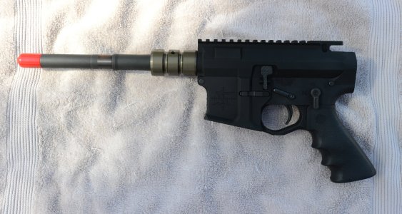

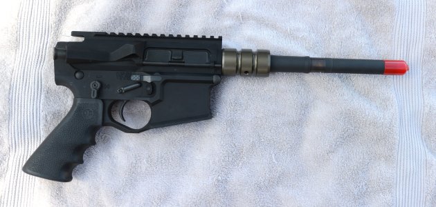

Above This will be a 10.5" .300 Blackout
-Vltor billet upper receiver with forward assist. I AM SWITCHING THIS TO A SEEKINS UPPER SO THIS UPPER IS FOR SALE. NEW NEVER FIRED. STRAIGHT OUT OF THE BOX. PM IF INTERESTED.
-No bolt carrier yet .
-Barrel will be 10.5" Noveske .300 blackout
-Geissele 9.5" MK4 rail shown
