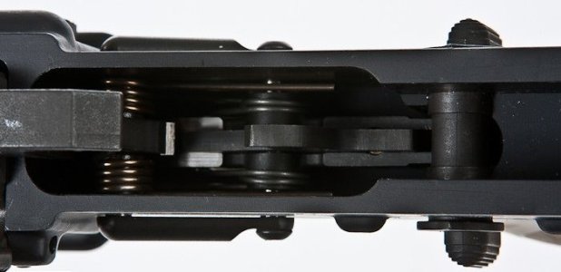

Take 3 pictures, left & right side of rifle, and down into the trigger assemble. make sure the last one is clear and shows the hammer spring. Comment on when the pin falls out, while shooting or when assembled. What brand rifle and aftermarket or factory trigger.

Check your pins, they should have a groove in the middle and at least one groove on either end (or both). If the pins have the grooves, check the hammer to see if the "J" spring in the hammer is present (that is what the center groove is for and keeps the pin from walking). If you are using a drop in trigger unit you will more then likely need a KNS pin kit.

That would be the hammer pin (not the trigger pin). If that's the case (and the trigger pin isn't walking as well), any further pictures probably wouldn't help, as the most likely cause is the internal J-spring inside the hammer barrel. It's either broke / missing or doesn't have enough tension / protrusion.
