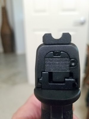

I just bought a Springfield XDS Mod 2 with the front night sight. When sighting the front sight through the rear it is tight. Meaning there is no light on either side of the front sight. I like a lot of light on either side so I need to open it up.
It has a U notch rear sight so trying to figure out the best way to do it. I guess I could file or dremel it open and use some cold blu.......if I destroy it replace it.
Any ideas on a better way to go about it?
Thanks for any replies.

Since you want a lot of light on both sides, I would not worry about opening up the rear sight by hand. I would get a square file, in a size that is you minimum width for opening. Start slow, VERY SLOW, and work the filing as straight down as possible. Since you are not a machine, once you file it as deep as you want to go, you will have to shoot it and file on the side that will correct your point of impact. IE,... if it shoots left, file a little at a time on the left side, shooting often to make sure you don't take too much off. If you go too far, just file a little on the right side.

All good stuff here but for me the direction seems backward.shooter444 wrote: ↑September 26th, 2019, 11:45 am you will have to shoot it and file on the side that will correct your point of impact. IE,... if it shoots left, file a little at a time on the left side, shooting often to make sure you don't take too much off.
On the REAR sight I would file on the side I wanted to move the Point Of Impact towards.
As in if Point Of Impact is left of Point Of Sight I would file the rear sight on the inside right side of rear sight.
Of course , if the rear sight is drift adj, who cares ? file in the middle .
But as Shooter 444 says , Go slow,,,, check often.
This is for sure NOT a job for a Dremil , Strictly a needle file thing.
