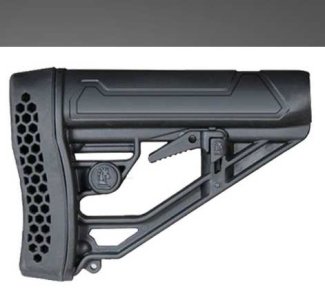

For recoil reduction I use this on my 300 and 458 SOCOM:
