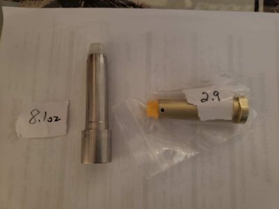

I have counted the springs that I have and most are 10.5 inches or less. I have 2 different buffer weights for this 9 mm upper that I bought at the less Phx gun show. The seller said that I would need the 8.0 oz weight to make it work properly. I also got a spring from the seller that is almost 11 ".
I put the upper on this lower and it worked good. But the problem is that I want to make a dedicated lower for this upper or change out the brace. I can't seem to get the rubber brace off of the buffer tube.

The 8.1oz buffer looks like it is already elongated for a PCC, eliminating the need for the plug.
An "almost 11" spring is most certainly a rifle length AR spring. While that will work in a carbine, which yours with a collapsible stock will be, I'm not sure it will run, or at least run well on a 9mm.
9MM AR are not that hard to get running. I would use the 8.1oz buffer, the length will help protect the bolt catch as Delta6 described, and a standard carbine length spring to start out with.
