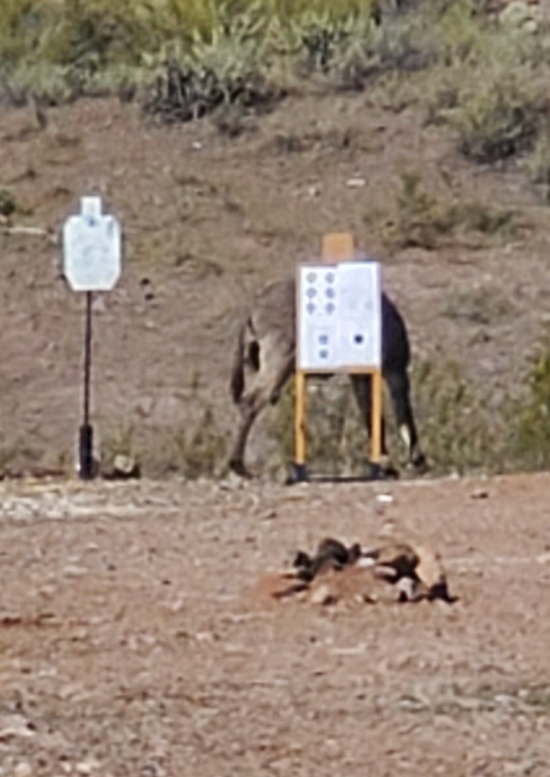

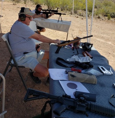

LOL, free is right, sobs musta shot a hundy rounds in the name of making a unit run, and setting up dot optics, hehe, yeah fun day was had, ammo no big deal, i got lots, heheh, everything went as planned, except that extar, its ok, but not sure i'll be putting a long wait item on it for a long time,

I'm wondering about the validity of "free ammo".
Now, if testing is required bring the ammo and let's do this!
I don't see no stinking Extar EP9 in that picture. Kind of like those unicorns.
Peeees on your targets you filthy shooters

all i saw was asses
