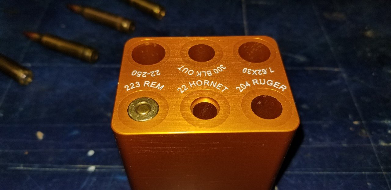

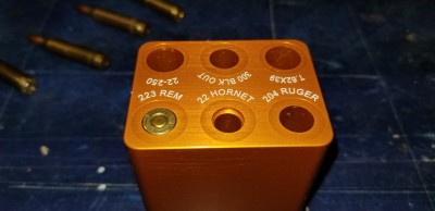

Update: Just got a case gauge today and tested a reload, matter of fact I tested several and they all passed, image 1. Then I conducted a Plunk Test...all failed miserably much like cjr had stated...image 2. The rifle barrel is a 5.56mm chamber.
