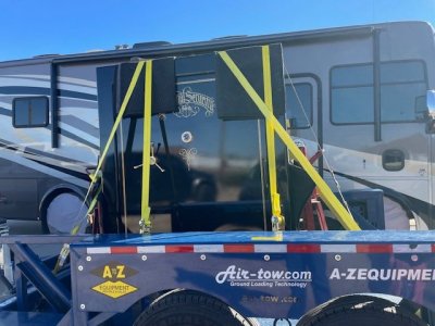

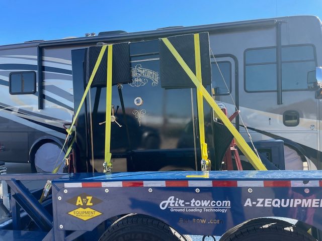

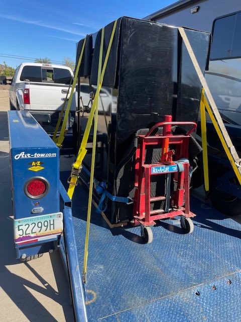

rockbronco
Posts: 540
Re: Safe Movers?
Post by rockbronco »
Here was the setup I used
The person that needed it moved called multiple places and the price started around 1k and left open ended until final delivery. Most didn’t want to mess with it based on size and weight estimates so I wouldn’t be surprised if that price was quoted high to not get the job. It was clear to them it was a garage to garage move. No stairs or doors to deal with. I do not know if he checked with the reference posted here or not.

rockbronco wrote: January 22nd, 2025, 7:15 pm Here was the setup I used
holy smokes, that is a big-un!
rockbronco
Posts: 540
Re: Safe Movers?
Doc wrote: January 23rd, 2025, 6:10 pm
That’s what she said….quite literally :lol:
It was no joke to move but this setup certainly made it easier than you would think. In total I think we moved it about 3 separate times. Hardest part was keeping it from moving on the trailer and getting it level at the final destination. This is where the Johnson bar comes in handy to lift a corner at a time to shim it.
