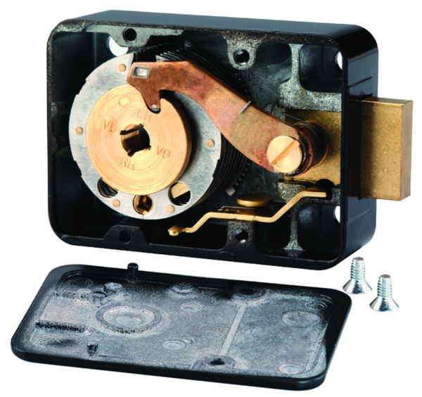

Weird, and as it is the weekend, no help available so I thought I would throw it out here.
Last December took receipt of a new Liberty safe with mechanical lock. Lock worked fine as long as you did not mess up the turns.
Yesterday morning, opened and closed it several times. Afternoon go to open it and do net get the usual "stop" at around 87 so the handle would operate.
Tried the +1,+2 and -1,-2 tricks. Nothing. Was told that should not be the issue with a new lock.
Anyone hear of this happening? Will try the safe place I got it from come business hours Monday. Do not want to pay for an emergency call on a safe should be under warranty.
So much for the reliability of mechanical locks

Watched a video of the inner workings of a S & G lock. With some BFG (rubber mallet) banging about the spot I figured all should be lined up, it released and the handle turned.
Now of course I do not trust it to lock it again. Would seem like a bit of lubing or something if it did not want to slip in without the thumping. Emergency call said the numbers should not have slipped on a new lock, so it makes sense the hook thing was just not slipping into place.

Sounds like a burr, or a/some metal shaving issue. Have the whole lock assembly gone through under warranty. KY jelly is not the fix!

Liberty replied after suggesting all the "usual" jiggery pokery with +1,2, etc. The tech did mention that it was unlikely a fairly new lock would have slipped a number.smithers599 wrote: ↑September 14th, 2022, 10:19 am So, QuangTri, what's the after-action report? Did the dealer clean, lube, repair, replace?
They accepted that it was hosed and are sending a new lock to the safe dealer for install and issued a work order. Would imply they expect the lock to be messed up.
Dunno how long to get a lock from Payson Utah to Tucson. Still waiting for Road Runner safe to contact for the replacement work.
Being able get in and recover stuff took a load off my mind at least. Be climbing the walls if my toys were in there.
Further unlocking tries with the door open do not work, seemed to be a progressive failure. Very intrigued to find out what went wrong. Just had a feeling mech locks worked forever.
