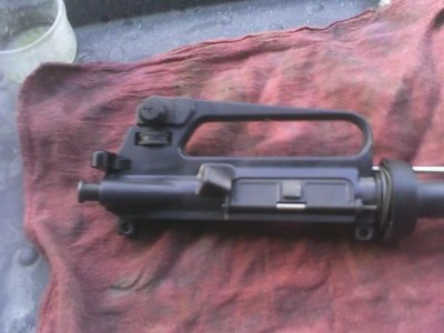

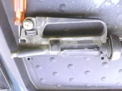

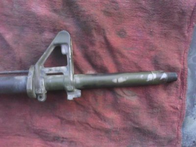

lacquer thinner and scrub with various plastic brushes
before/after of an upper I snagged from another member of the old AZS site
once all the paint was off I just sprayed it down with WD40 to re-oil the original metal finishes and wiped it down

Wow! It cleaned up really nice!sonofbp wrote: ↑June 22nd, 2020, 3:01 pm lacquer thinner and scrub with various plastic brushes
I just picked up some Rust-Oleum Aircraft Remover and some brushes, so I'm going to give it a go in the next couple of days.

I was surprised how well it turned out, it must have been the 4 layers of crylon protecting the original finish all those years lol.
I've heard good things about the rust-oleum aircraft remover but already had the lacquer thinner on hand so I gave it a shot and it worked very well and was happy with how it didn't stain or remove any of the original finish.
hope it turns out well for you

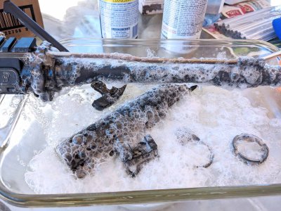

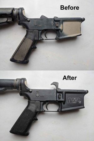

I gave it a go with the Rust-Oleum Aircraft Remover, and I have to say, I was pleasantly surprised. It's more of a foam than a liquid, so I didn't even smell it when a sprayed it outside unlike if I was using solvents.
Below is what it looked like when I applied the stripper, and then you can see the before and after of the lower. It could still use a little touch up with some lacquer thinner and a fine brush, but I was pretty happy with the initial results.

Yes, I sprayed it all over the grip. It didn't affect it at all. I was going to try a spot of the stripper on the braces rubber to make sure I don't melt the who thing. So far so good.

The key with using the aircraft remover is just to let it sit on the paint for 20-40 minutes as directed. On thicker areas, I had to follow up with a second pass, but I didn't have to let it sit as long for the follow-up. I used some little disposable horsehair chemical brushes to scrub away the paint, but I'm not sure if something else would have worked better. I know that I really could have used some little round brushes to get in the holes on the handguard. That was hell.
