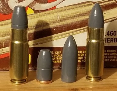

In the pic below you can see the two primary cast bullets I shoot in my SOCOM. on the left is a 360 gr PC coated with a gas check that is my standard plinking bullet. The crimp groove in the bullet is placed for use in the 45-70 and this shoots great in that also. On the right is a 500 gr. spire point cast bullet that I use for shooting subsonic in the SOCOM. PC'd with no need for gas check because I am shooting it slow. I shoot lots of both of these as my go to bullets that are easy to make and cheap to shoot.

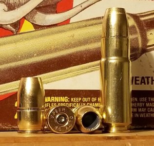

In this pic you can see the JHP bullets I make using cut down .308 brass as the jackets. The one in the pic is a 405 gr. JHP with a cannelure in the proper place and then one in a loaded round.

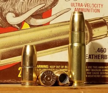

This is a 300 gr. JHP made from a .45 ACP case as the jacket
