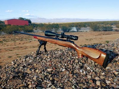

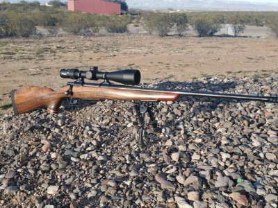

Re: Gun Stock refinishing
Here is one I finished up not too long ago. This has got about 30 coats of pro custom gun oil and buffed with rottenstone to a satin finish. The first few coats I added some bone black to the finish to fill the pores of the grain and make it pop.
