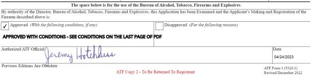

To be clear, you don’t get a stamp. It’s just your information on a 4 page PDF that is check marked Approved.

Winmagbill wrote: ↑May 11th, 2023, 4:40 pm To be clear, you don’t get a stamp. It’s just your information on a 4 page PDF that is check marked Approved.
