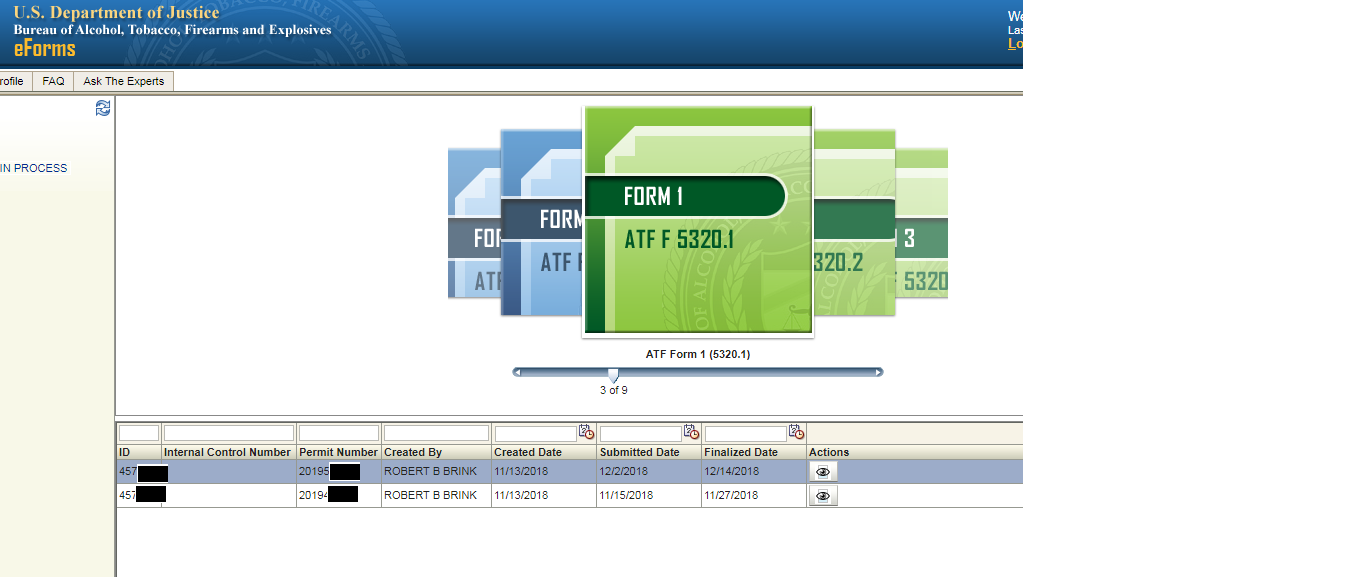

I've had two eForm1s returned in under two weeks. Click to enlarge. You'll have $200 in the stamp, but the rest depends on your skills and available machinery. Simple kits that you basically just drill are a couple hundred bucks.
Just an example I found online.
http://www.quietbore.com/#!/Solvent-Tra ... ort=normal

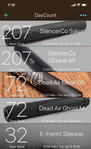

I'm aware. In for a few.
This is my current stamp wait times list.
