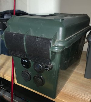

I have 10w and 100w panel I keep around for camping. Haven’t had the chance to use the 100w. Most Solar controllers have a USB port on them. I built a battery box with a 7amphr battery and the small tackle box. Hook up to the solar panel controller and I’m good to go. Plenty out there but they aren’t cheap. I preferred to build mine. Sometimes slickdeals site post some decent deals.
This is a bigger one but you get the idea.
