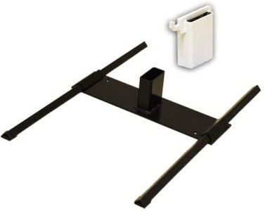

I've made several stands using 1x2s. I always make the base attachable with 1/4 screws and wingnuts so no tools are needed to assemble.
Another option I use is the plastic folding stands commonly used for real estate "open house" type diplays.
My favorite is the AR500 steel target base and hanger that use a wood 2x4 as the verticle member connecting the two. You can cut the 2x4 for whatever height you want and replace as necessary.
RR
Note- those legs slide out of the base for further break-down
RR

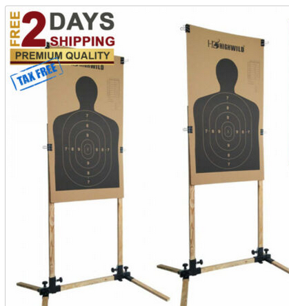

This is half DIY, I ordered this two pack on ebay.
You can widen them out to have multiple targets on one stand, and use longer sticks on the leg portion for those breezy desert days.
https://www.ebay.com/itm/Premium-Adjust ... 4437676635
