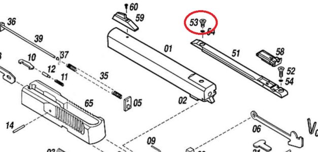

"Someone" snapped the tip of an allen wrench off in the front screw of their Buckmark's site mounting plate (see image below)... Must have been a cheap Chinese tool because there was really very little force applied and it had only deflected a couple of degrees when it yielded (yes - I've since picked up a set of "good" allen sockets). It yielded completly flush with the screw face so there is no way to grasp the nub with anything.
Anyway - I've tried tapping it lightly with a drift (on as much of an angle as I can get) to losen it in hopes that I can get it to drop out - no dice...
Any other suggestions / tips / tricks that I should try before putting it in a padded vice on the drill press and drilling the head off of the screw?

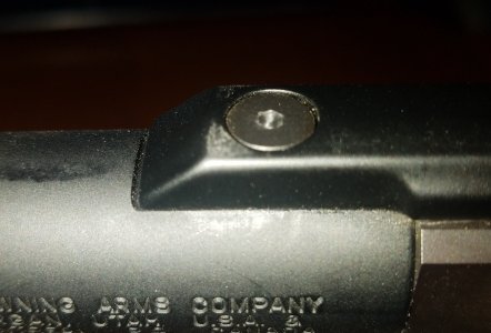

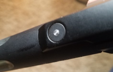

dread_scott wrote: September 11th, 2020, 10:39 am Is it magnetic? Put a strongish magnet on it and see if it pulls out? Maybe also heat it up a bit?
Do you have a pic of the actual broken piece?
Here are a couple of pictures... It is pretty flush...

The best way is to use a small carbide burr that's smaller than the allen hole. It's best to use a drill press and basically grind away at the center until it can be popped out. I've done it to similar types of broken tools like this many times.

I recently had something similar happen to an expensive piece of equipment at work. I used a dremel to cut a notch across the screw and broken key and once big enough use a flat head screw driver to turn it out. Mine was a bit easier being a button head allen screw. In your case I would use one of those amber stone cutoff wheels on some other scrap steel to wear it down small enough to get in there without contacting the slide cover. Perhaps profile your Flathead to match the curve of your cut if you can't get it very deep.

Dremmel cut-off wheel, small flat head screw driver to remove it, contact Browning (or Natchez) to get a new screw.

That's my thought. Use a Dremel cutoff wheel to cut a slot into the Allen wrench piece, turning it into a slotted screw. Then use a screwdriver to unscrew it. That process will also cut into the surrounding area, but no big deal; nobody is going to ever notice.
Or, drill a tiny hole into the top of the broken piece, then hammer a slightly oversized small screwdriver into the hole, and unscrew the piece.

That's worse than I thought... I think Pale Rider has one solution- drill it out with a flat bottom mill and collapse the sides in... or like the others said, grind a slot and unscrew the whole thing then replace the screw from browning - or maybe send it back to them to fix...

Thanks gents... I've ordered some tiny burrs and I'm going to try to cut the middle out of the tool and see if I can pull it out. If that does not work I'll slot the screw and replace it... if that does not work ... well ... I might be mad enough to go the oxy-acetylene route... :-P
