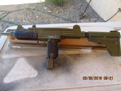

80% UZI
I've built many an 80% AR15, too easy. 80% Glock you can do in your sleep. 80% 10/22 easy except the barrel hole.
Then I grew a pair and took on the UZI. Good grief my welding skills have deteriorated over the years!

What welding process did you use? I am told that only TIG will suffice.

Re: 80% UZI
I used the cheapest wire feed welder that Harbor Fright sells, using the best wire I could find, and liberal amounts of this anti-splatter paste I got at a welding shop. And lots, and lots of practice, which I think makes the most difference, by far.

Re: 80% UZI
Did you use a jig, Brian? She looks good and true. That trunion weld needs to be a beefy beast, seemed to be an alignment concern for some builds from what I have read at Uzitalk. Anyways, good on you.

Re: 80% UZI
Thanks!
No jig here. I used a really good repair section, and I only had to line up the front section. I measured and cut, measured and filed, and filed,used a spirit level, filed some more, then used the barrel to approximate the final alignment. Then filed some more and welded.

Re: 80% UZI
Looks good Brian!, have you tested yet and how many rounds? If so I am sure you have rechecked for cracks?

Re: 80% UZI
Only 25 rounds so far. The desert has been closed due to fire hazards, so I may have to go to an actual range. I look forward to a torture test. I can always re-do my welds, that is, if the bolt isn't imbedded in my face.

Re: 80% UZI
Liquid Penetrant Inspection using dye is what I have used and a good magnifying glass.

Re: 80% UZI
Repair section= $88.91
Parts kit= $188.90
"Weld up" kit= (misc small parts) $117.39
Semi Auto bolt and sear= $323.39
Barrel= $109.99
Buffer tube mount= $31.90
Shockwave blade and buffer tube= $58.98
Welding, re-welding. re-re-welding
burning myself, endless hours scratching
my head and swearing= $Priceless
Al prices include shipping, alcoholic beverages extra.
