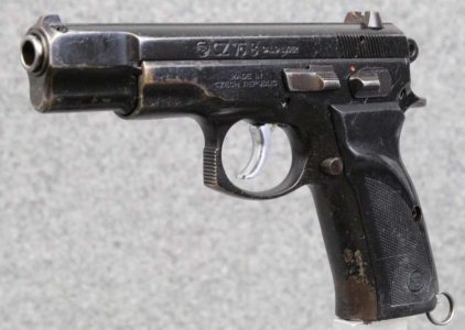

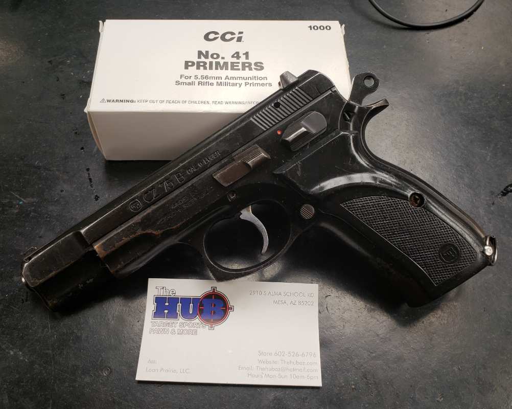

Just won this beauty on Gunbroker, should be a fun refinishing project..
I'm thinking either SOCOM Blue or Black on the slide and whatever shade of Grey Cerakote I have on the shelf for the frame. Replace the sights with a new set and a new set of CZ Custom aluminum grips.

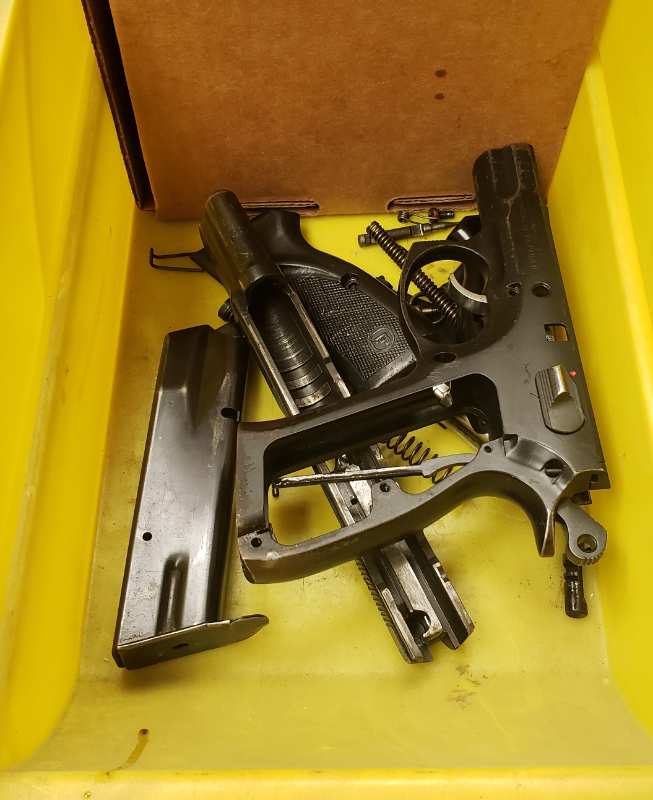

USPS just dropped the gun off at the shop today, got it mostly torn down. Had to order new Cerakote because the stuff on the shelf that I wanted to use was no good, so the stuff is supposed to be here next week. Internally the gun is in really great shape, outside it is kind of ugly.

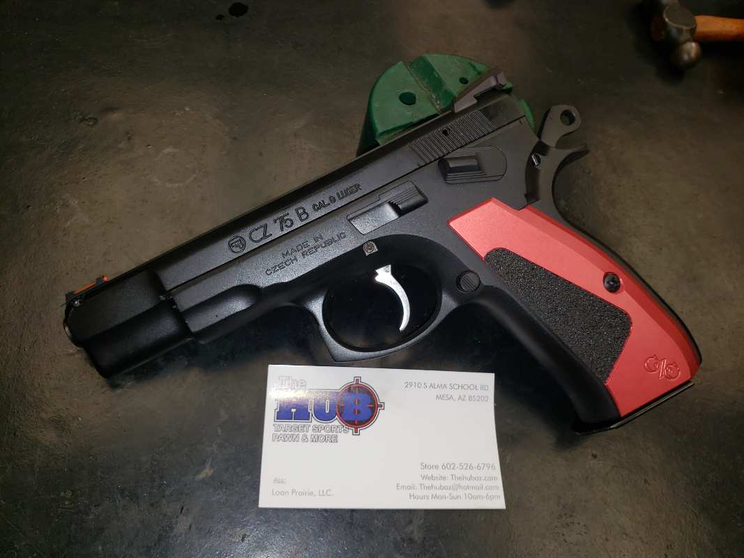

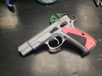

Stopped off at CZ Custom this morning and picked up the sights and grips. Changed my mind and decided to go all black on the frame/slide and went red on the grip panels...

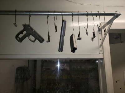

Everything is blasted and ready for Cerakote.

I use 80 grit Aluminum Oxide, you want etching over peening so the paint can bite into the substrate.
