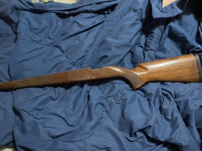

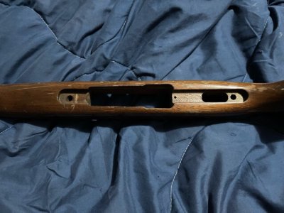

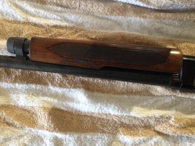

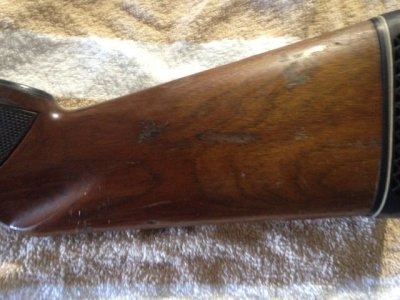

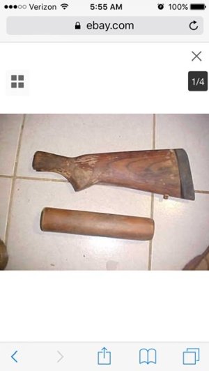

Project I just atarted. Refinishing an A bolt stock with a Linseed oil finish. Will post after photos once finished! Who else prefers linseed oil hand finish over the old resin/poly coating some of the older wood stocks had?
Pictures are what I started with. Already stripped old finish off and steamed dents out. First coat of oil has been applied, need to take pictures

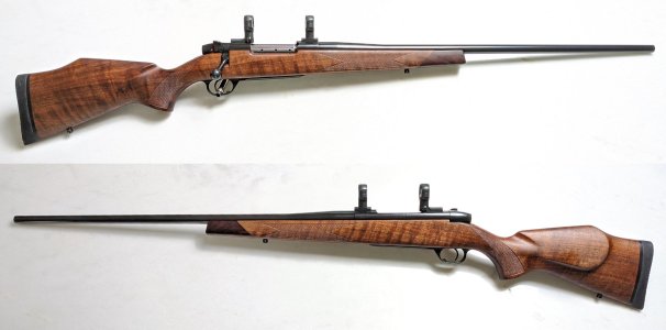

I really like finishing will oil as well. This is a stock I redid with Danish oil last year. I actually did finish it with a few coats of satin exterior poly to add a little more protection and still keep the sheen down. I really hate the high gloss finishes. Just my personal preference.

Looks awesome! How does tung oil compare to linseed? And which satin poly did you use? I may finish with a coat to protect it
Im finding the stock I have is a lower grade wood, but it was given to me so im not complaining.

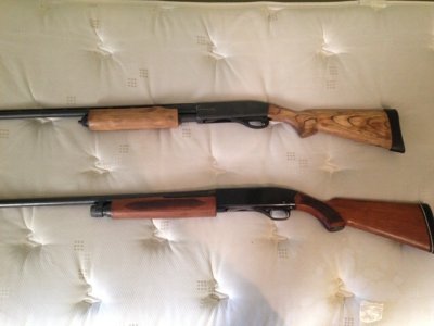

I did two shotguns in the past, was very happy with them. The really beat up one is the top one in the finished picture.
