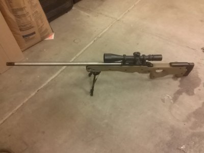

I just finished building up a Rem 700 in 300WM and have 40 rounds through it so far.
It started out life as a new stripped receiver, bolt and Xmark trigger. Barrel was a Shillen profiled blank and AI stock. The scope is temporary till I can find one that will compliment the rifle. I will be getting caliber info engraved on the barrel then add a finish here shortly.

muta4warrior wrote: May 19th, 2018, 10:16 am I just finished building up a Rem 700 in 300WM and have 40 rounds through it so far.
Looks good to me! What's wrong with the NF? And what are you thinking of going with in it's place?

Basher wrote: May 19th, 2018, 2:29 pm
The NF came off my 30-06 that uses the same scope rail as the 300WM is using, so it was a quick drop and go.. I was thinking about a Vortex Razor of some flavor.
