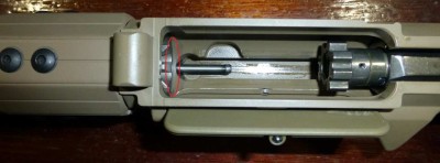

The light primer strikes are a different thing. Is the back end of the barrel extension flush with the back edge of the spot in the upper receiver where it sits - or does it sit proud into the area (talking about the interface seen in the red mark in this pic stolen from the interwebs)?.. Any chance you have a headspace gauge for .308?
Again - I'm no gunsmith - but if folks want a ton of money to look at it - I'd be happy to try to troubleshoot with you. It could be a moneypit nightmare... it could also be something that a gas block adjustment or spring / buffer swap resolves...
