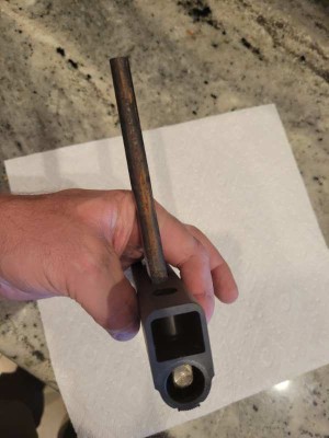

OK - I got it back together last night. It took a bunch more attempts and two sets of hands - and my soft keyboard-warrior fingers are raw this morning as I type this... but it is back together.
The fix went like this:
1) Make a tool that goes into the receiver from the bottom with a leg that fills the space in the receiver where the bolt gets inserted (pics below).
2) Compress the spring and the spring guide pin into the bolt
3) Push the back end of the bolt with the compressed spring into the receiver releasing the end of the pin into the tool to keep the spring and pin in the bolt.
4) Push the whole mess back into the back of the receiver - maintaining pressure on the bolt and tool to keep the pin in the bolt.
5) Hold the bolt in the back of the receiver with a drift and rotate the tool out - letting the pin come out of the bolt and seat in the recess at the back of the receiver. It took a few tries to figure out how to do this slowly enough and with the right pressure on the bolt so that the spring didn't "pop".
6) Continue to hold the bolt back at the back of the receiver while putting the charging handle into the bolt and then screwing deflector (which serves, with the charging handle, to keep the bolt from coming too far forward when the barrel is installed) back to the receiver with two tiny screws.
Once this was done - the rest of the assembly could continue.
I'll say this - I can't see how this could be done by a single set of hands without some very specialized tooling. I agree with the guy in the video - I have no idea how zee-Germans that engineered missed that this assembly is / was a colossal mess for the typical gun owner. Unless the intent of the manufacturer is that the gun owner should never pull the bolt and clean it - this is a really bad design.
So - the tool...
The tool... took a piece of 1/2" round stock, bent it 90 degrees (ok - bent it about 95 degrees and had to bend it back) - then drilled the end of the short leg to cant the surface to the inside so that the pin would not slide out/off. Ground the sides down such that it was narrow enough to fit into the receiver through the opening where the fire control group / trigger assembly seats...
The tool in the receiver waiting for the bolt / spring / pin assembly...
So - the tool...
