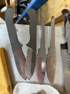

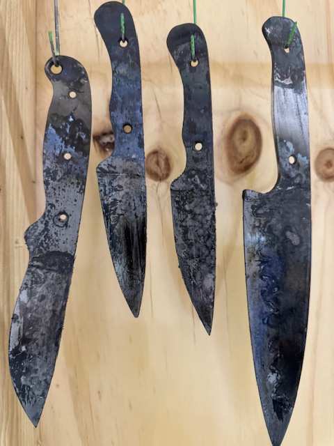

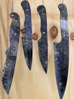

Sorry to hear about the OP's health. Agree about the weather though. Now that its cooler I can finish my current projects: 26C3 should turn out with a decent hamon. Hope to have some nice WA style handles for the hidden tang
AEBL/14C28N
AEBL/14C28N
26C3/Hamon
26C3/Hamon
Posts: 4903
Reputation: 24
Re: Knife making...?
^^^ Did you make those blades?
theflatline
Posts: 67
Joined: June 5th, 2018, 12:03 pm
Location: North phoenix
Post by theflatline »
Yeah, these happen to be all stock removal. The bottom ones were just finished with heat treat and the top ones are almost ready for heat treat.
