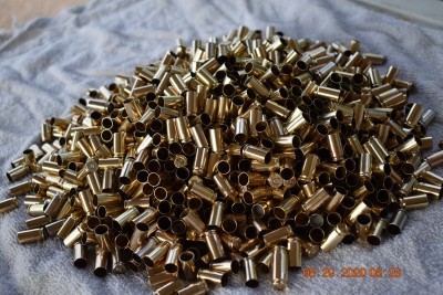

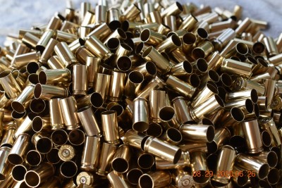

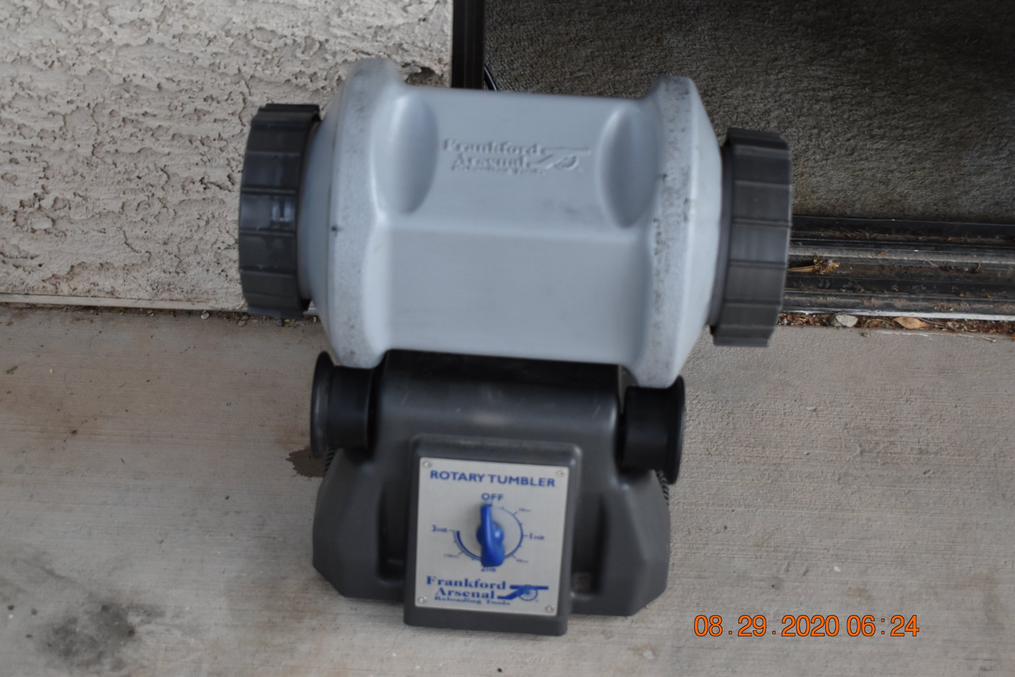

Like a lot of OFWG reloaders, I started many decades ago dry tumbling brass in a vibrating tumbler.
A few years ago, I decided to try wet tumbling. I loved it, and never looked back.
But using those little stainless pins as tumbling media was such a pain in the ass. It was a chore trying not to lose them, and even worse, to inspect every case to be sure no pins were stuck inside. This was especially bad with revolver cases.
Then last year, I decided to stop using media. Best idea ever.
I tumble using a few squirts of Dawn for a couple of hours.
Dump out the dirty water and refill with water and Lemi shine.
Tumble for an hour, drain the dirty water, refill, and tumble the rinse cycle for a few minutes. I like the results. The brass ends up as shiny as brand new, and I no cussing over those damned tiny pins.
What do you think?

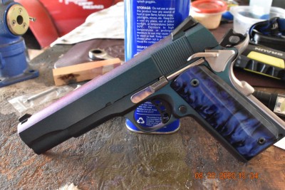

I wanna know two things:
1) More about that sweet 1911 (which barrel, internals, etc).
2) How clean and shiny the insides of the cases and the primer pockets are without the pins. The outside sure looks purty...

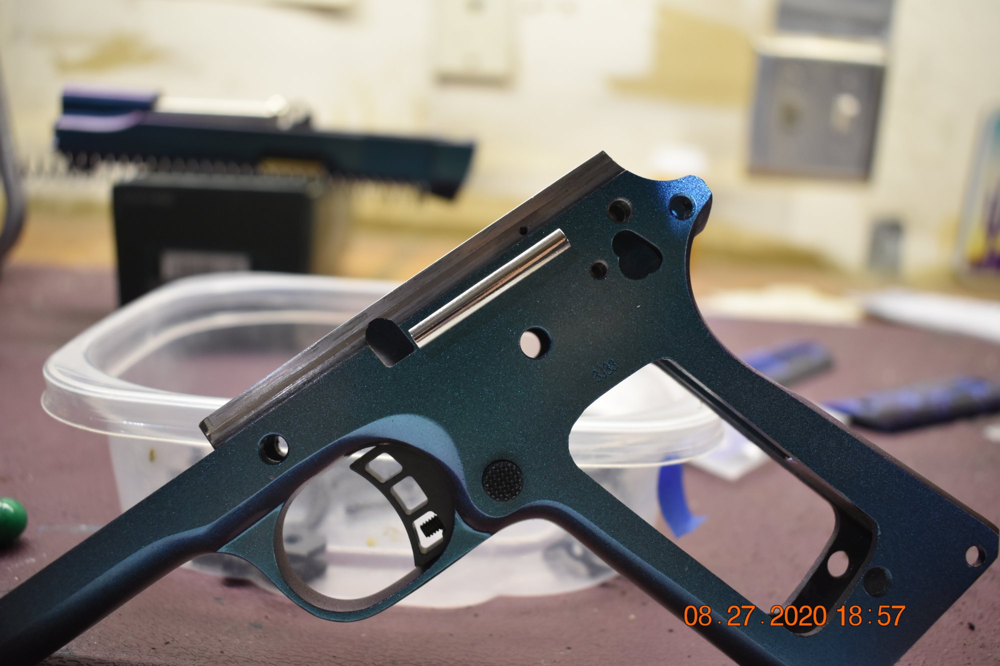

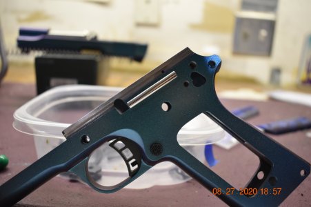

Thank you. I'll post one more time. Its hard not to comment when your ego gets stroked. That was an 80% 1911 kit I bought before the panic. This was an easy one with a Rock Island frame and slide. Minimal fitting, but not exactly "match grade". Can't remember where I got it. (Or a lot of other things these days)
Inside of the cases are very clean, but not shiny. I'm too lazy to deprime before I tumble. That goes for my personal life, as well as my reloading.

No pins for me. I used them twice and just not worth the extra work. I started with Dawn but now use car wash soap with wax. I add Lemishine in the first tumble, run about an hour then dump out dirty water and start flushing the barrel with a water hose. Shake a couple of times and when the water flushing out of the barrel is clean I dump the brass on a drying screen and let the Arizona sun do it's job.
Never knock out primers first, also not worth the effort. Brass comes out more than clean enough for any reloading job.
