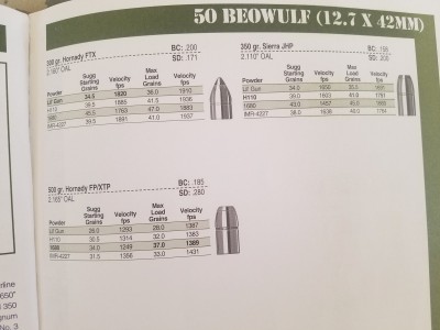

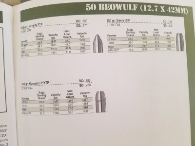

This is what I have. O by the way , good luck finding brass cheap.

Thanks for the specs.I have powercoated and gas checked the cast projectiles,they look great. looking for cast bullet loading specs or experience with them.
