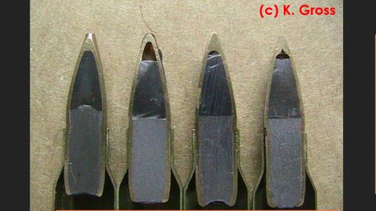

What is so special about green tip ammo? Is it armor penetrating?

It has a small steel core and is said to be light armor piercing, (LAP). Nothing really special about it in my opinion. I’d choose accuracy over any LAP round

I shot standard FMJ and green tips at my steel plates. Maybe the green tips would have more of an impact on thinner steel, but they didn't even seem to indent the steel any different than the standard ball rounds.
That's just my experience, but I'd be curious if anyone else has seen a big difference in certain types of targets.

It'll ding up thin steel pretty good at closer ranges.
Otherwise it's less accurate in my experience than the 55gr 193

Less accurate and punches up,steel

That's a couple of people that have said it's less accurate. Does anyone know why that is? Is that maybe just from certain manufacturers or is it just the nature of those bullets?

I have a couple AR500 targets. The green tip makes a large "splash" in it. Quit shooting them with it.

I believe it could be less accurate because of the steel core causing imbalance of the projectile

In accuracy the right twist rate is key. Longer projectiles require faster twist rates, this is why the good calculators require that you enter the projectile length. (Yes, weight too is enterd. However, then the projectile diameter cannot change to accommodate the weight . . The bullet must get longer). Berger has a good calculator on line but is primarily designed for boat tail bullets.
You can also "over stabilize" a bullet. Bullet makers are getting much better at producing concentric jackets. But NOTHING is perfect. If the core is out of rotational center , then the faster the bullet is spinning the more kinetic energy there is in sideways movement to throw the projectile off target. This is why some stability calculators have a scale to show you the stability. Moderately Stabilized , Optimally Stabilized, Over Stabilized.

It will work fine most times but it's a multi piece projectile.
Lead>hardened steel tip> outer jacket
All made by the lowest bidder. In different countries to just slightly different specs.
It's not inaccurate, it just wasn't made for match work.
Its minute of Soviet horde accurate.
