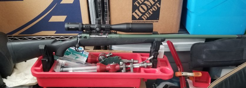

I put together a 6.5 on a savage action and would like to load some 140 grain hornady eld, anyone want to share a powder type and a good starting point, any help would be appreciated
